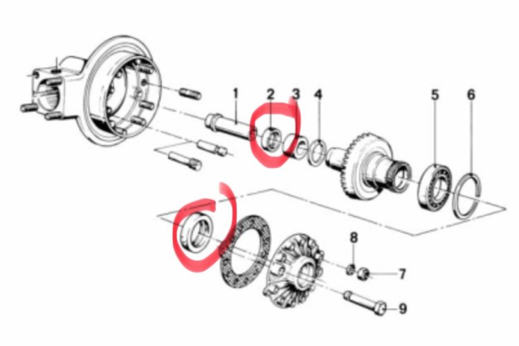

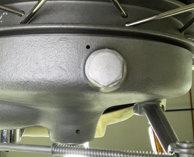

… actually, there are two(2) “weep” holes on the Rear Drive: one for the outboard seal, one for the inboard seal…
View is “worm’s eye” looking at bottom of rear drive housing. The lower one in this image, is for the outboard or axle nut/washer side of the Crown Gear Seal (#2); the upper one is for the inboard or Crown Gear Drive Spline Seal, also circled in red…
Should the outboard seal fail, gear oil will weep thru the outboard hole, alerting the rider of problems. The inboard seal failing, will be slung-off and drained into a circumferential “trough”, away from the rear brake components, to its weep hole.
Interesting...I never knew about that lower one. I had to go check my /7...get rid of some dirt/oil ;) ... and there it was! Thanks!!!

Getting a slight weep from upper drain hole on refurbished final drive I bought. 30 mile highway ride. Very slight weep, I think. Hoping it was just a new/dry seal settling in.
Did 8 mile mostly highway drive. Dry. 2 hours later did return trip. Dry.
Did a 40 mile ride this morning - dry. A few hours later, returned, 40 miles, slight weep.
Checked final drive oil level- half way up threads.
