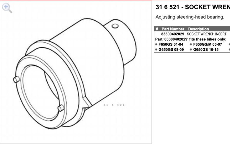

It appears that a special tool is recommended for the job: socket wrench tool # 88300402029. I would like to ask if anyone has one of these for sale, rent or loan in the Chattanooga area. I can buy the tool but I will probably use it only the one time and it runs $100.

Well known problem for that style of bike unfortunately, the heat from the oil tank doesn't help either. It seems that adjusting the preload after the first couple hundred miles and at least a couple times after that, may increase the bearing lifespan.
If you don't find the appropriate tool, some auto parts stores have adjustable pin wrenches that may work that you can buy/rent. You can also use an adjustable jaw pliers carefully. I'd also email you local BMW club if you haven't yet, someone may have one too.
Heating and freezing the bearings/races will make your life much easier!
