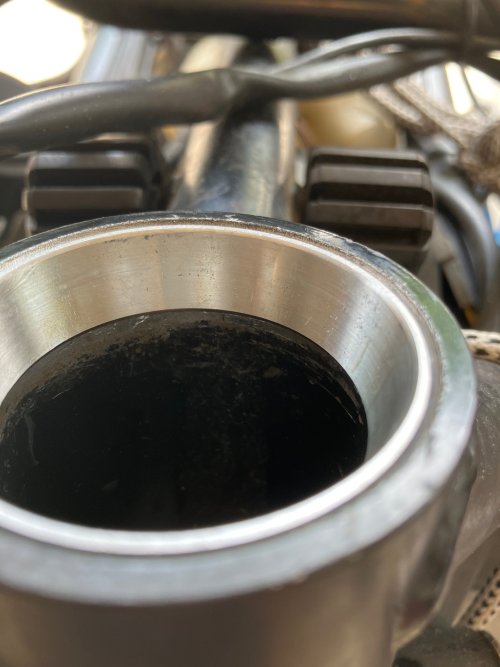

Hey @98lee - I'm halfway through this project, and just seated the new races. Seems the top is fully seated when flush with the top of the tube, while the bottom is fully seated when recessed by a 1/8 inch.
Is that as expected? See below.

Just make sure each race is firmly seated against the shoulder in the steering head tube and you should be good.
Frank
Thanks, Frank! I guess I'm just concerned that if the race is recessed (though seemingly against the shoulder), then the bottom bearing won't be held fully in the race, since the bottom yoke presumably won't press the bearing up that high.
Rob
Just make sure that the width of the old race matches the new race. Compare the inner races. Also you can test-fit the steering stem by hand.
Yep, inner dimensions are the same, top and bottom. Just worried the recessed lower race is going to cause a bad fit for the bearing. Definitely contradicts Clymers.
Okay, got confirmation on another forum that the recessed situation is the right one for the lower race.
So looks like I'm good to go.
