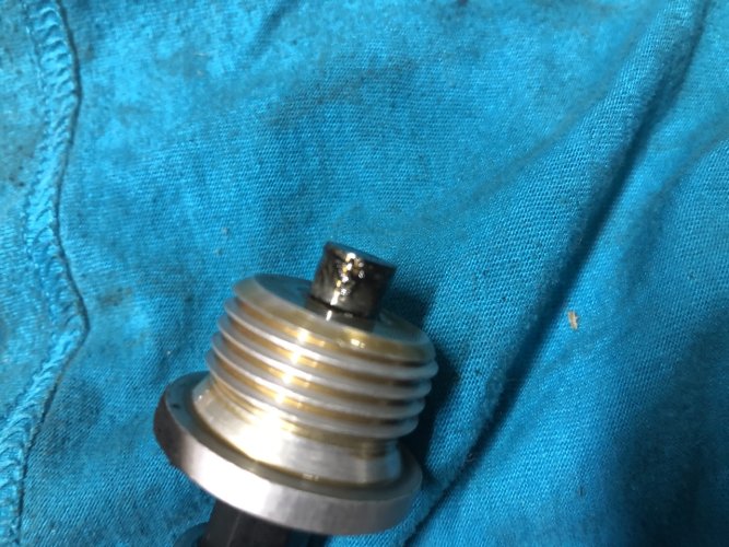

Note 3: Early model F-twins came with a 24mm bolt as the drain plug, most were (and should be) replaced with the style that uses a 10mm hex socket. That "new" drain plug BMW Part Number is: 11 13 7 708 604
