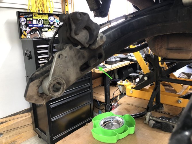

Double check that the rear brake carrier is still seated on the guide of the swing arm (indicated by the green arrow).
