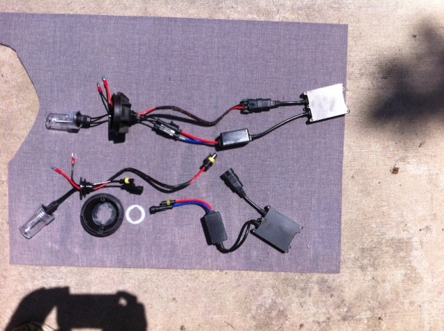

The following photo shows the DDM lights with the top part of the photo showing a completely connected unit (bulb with clear protective cover not yet removed, DDM low voltage supply the connects to BMW female connections, dust cover with grommet and spacer connected to cover, and ballast with three watertight DDM plugs. The bottom part of the photo shows the holes in the DUST COVER, the SPACER, and the grommet (the spacer is mounted inside the dust cover on the left such that the rubber grommet provides a good seal onto the outer portion of the DUST COVER.)

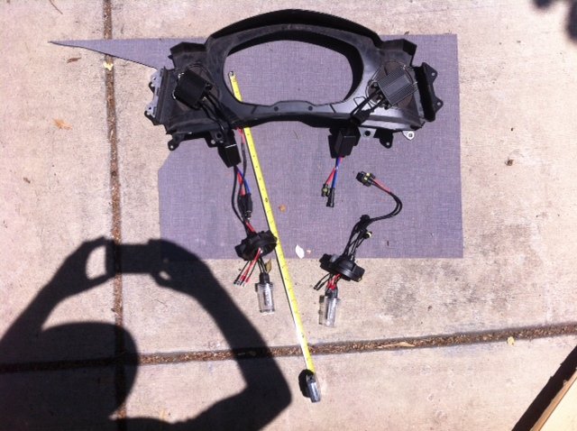

The last photo shows the ballast mounted onto the back side of the speaker dash cover.

This is where I installed my ballasts
I'm using the same screw to hold the ballast and the dashboard cover.
Easy access if it ever needs to be replaced.
