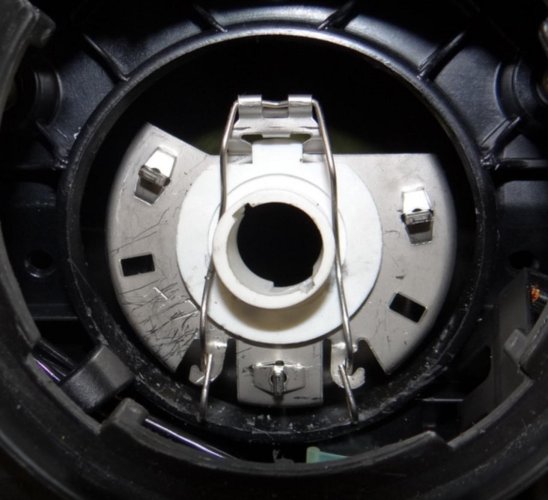

This can't be that bad. I have a little seat, I'm in my garage with all my tools. 10 mins tops! Having ridden once at night, the low beam headlight didn't wow me, so I thought I would give these Voltage Automotive H7 Headlight Bulb Polarize White Replacement bulbs from Amazon a try.
One hour later, the joke's on me. How on earth are you supposed to fit your hand in there? I had to rotate the bracket holding the horn in place by loosening the Torx 30 bolt at the top of the bracket, then I had enough room to work.
Sitting in front of the bike, in my garage with access to all my tools, it still took over an hour to change the H7 bulb. How you change this on the side of the road is just beyond me.
