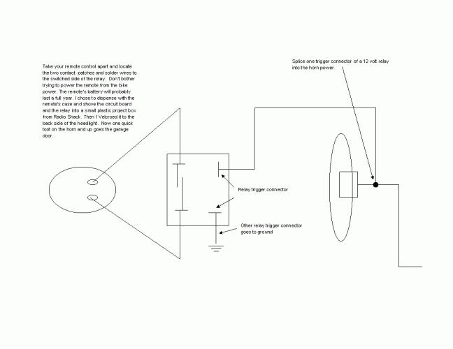

I use the horn to trigger a relay to switch a remote control on an off. Attached, is a crude schematic of how I set it up. IÔÇÖve used this for several years and it works great. I pull up to the garage, toot the horn and the door opens like magic. Toot it again and down goes the door.
Gail
