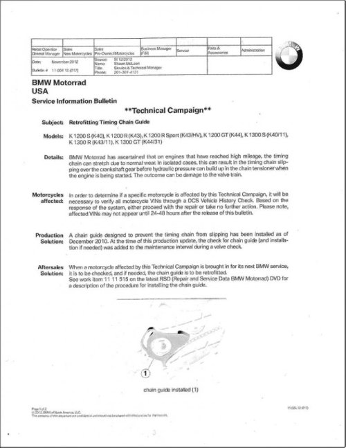

If you have one of these, make sure the jump guard has been installed.
That can be verified by removing the large Torx-drive inspection plug on the lower RH side of the engine--behind the RH fairing panel. With the Torx plug removed you should be able to just see the edge of the plastic chain guard.

The jump guard was corrected on 2009 - up bikes.
If you have one of these, make sure the jump guard has been installed. No arguments, no nonsense. Without it the chain can jump a tooth causing a collision between the piston and valves. CRUNCH! With it you are OK. Get it done!
