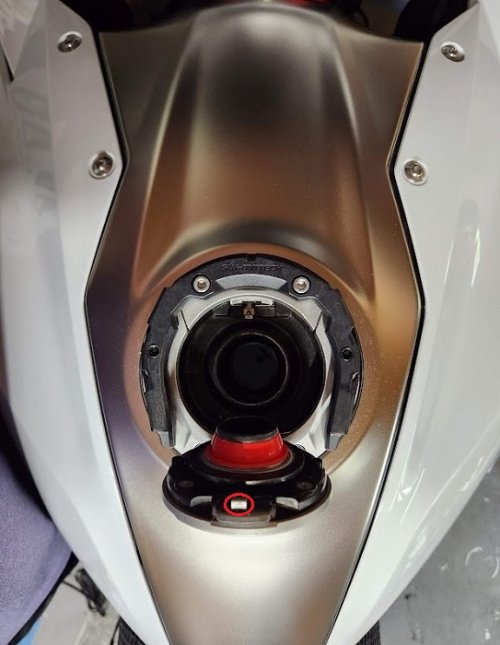

One guy came up with a simple solution to disable the lock. The cap will latch and seal but not lock.
I plan to do the same after the bikes are out of warranty.
Ray used a dremel to cut off the tab on the cap.
He cut off the circled tab.

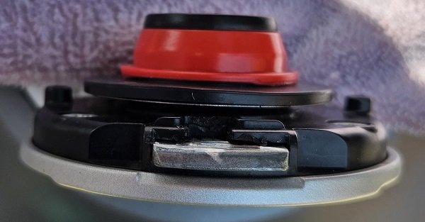

Looks like this now.
