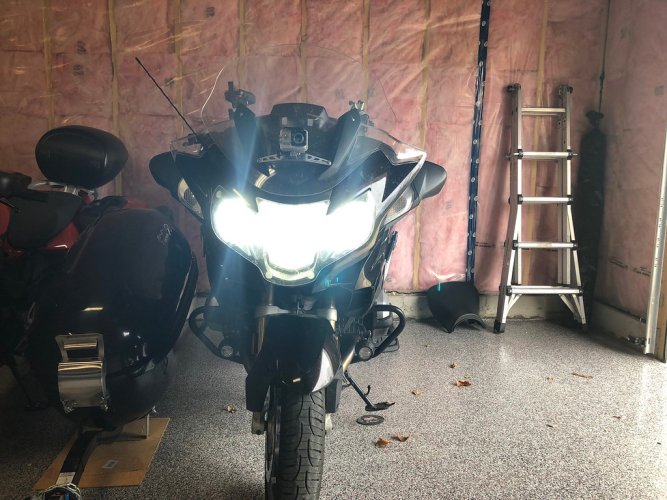

I too am tired of the regular bulb changes on my RT. I did manage to get the Cyclops H1's installed for the high beams, but no luck with the low beam. I did put the H7 in to my SO's F800GT and what a difference it makes. I find my main challenge on the RT is getting the clips to engage on anything other than the stamped metal flange on traditional H7's. I did look at removing the light array but after looking at the repair DVD I canned that idea - too much stuph to remove and then replace.
I've also tried a few imports from the far east, but one bulb lasted about 250km, and another just not bright enough. All of them have had the stamped metal flange. With one of them the driver got so hot that it melted the plastic it was resting against so now I have some Gorilla tape keeping the moisture out of the head light array.
Bulb showed up in the mail today, that's not bad for crossing an international border, having ordered it on Sunday. I'd rate the install difficulty at a 6 overall. Again, the hardest part is getting the clips back on the bulb holder. I did NOT remove the bulb from the holder and I was able to get the clips to attach with minimal difficulty. The reason I left it on the bulb was I didn't want to drop the holder in to the headlight array. I have done this before with another bulb install attempt - used a vacuum with a small diameter hose to get the holder out which was about 15 minutes of very loud cursing, so avoid removing the holder if you can.
There is ample space to tuck the webbing and the driver in the headlight array. Here's the what it looks like all lit up...
And with the H1 high beams on...
Finally, the backside with the webbing tucked in.
