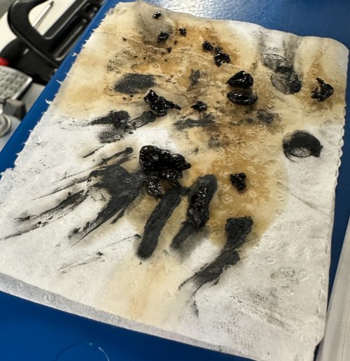

I just had the bike serviced and new tires today at my BMW dealer in Port Clinton, PA. The mechanic there told me that he found what looked like chunks of semi hard gear oil that came out when he drained the final drive. The bike has 6300 miles on it. I purchased the bike from a BMW dealer in central PA last June with only 2100 miles on it, but wasn't sure of the history on the bike. I did e-mail that dealer when I got home today to see what, if any history they had and if there were fluid changes when they had the bike.
I attached a picture of what came out of the drive and was wondering if anyone had experienced this. It appears to me that it was either the wrong gear oil put in on it's last change (whenever that was), or the gear oil overheated, or both. Luckily there wasn't any metal shavings, or signs of fatigue, nor leaky seals.

I suspect that somebody put moly-grease in the final drive and that it did not mix well with whatever fluid lubricant was in there.
That's a good point, I didn't think of that. The substance wasn't hard, it had the consistency of putty and didn't smell burnt, more like a lubricant (or grease) smell to it.
I agree, some sort of additive that didn't work well. Ride it and change it until it clears up.

That is the correct P/N for the finale drive gear oil. I agree that it looks like moly grease has somehow gotten into it. I'm sure Hermy's would not have given it back to you if they thought it was an issue.
Dunno how big that paper towel is, but some of those chunks look awfully big to be coming out of the drain hole.

The paper towel was about 8" on the narrower width. The smaller chunks are about 1/2" on average. The mechanic at Hermy's pulled them all out of the drain.
I put about 300 miles on the bike since this was found and the drive isn't running hot, or doesn't seem tight with rear wheel off the ground. I'm getting the fluid changed on Friday, 9/29 so I'll see how it looks.

Had the final drive flushed & filled today at the dealer. Big difference, few small pieces, but nothing like the initial change two weeks ago. Drive is running cool, no leaky seals. The machinic inspected as much as he could through the drain and fill holes and doesn't feel there's been any damage done. Still a mystery as to what this materials is. The service advisor did open a warranty ticket on it and there was no cost for today's drain/flush/fill. He also saved the particles from the initial change and today's change to submit with the warranty ticket. At least everything is documented.
