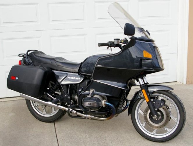

Good day,
After spending time looking for information and coming up somewhat empty handed, thought I would turn to the Airhead Group at MOA.
Bought home a 1992 BMW R100RT that had two previous owners here in Calgary. Overall it is in nice condition on the surface but we will see once things start coming apart.
The previous owner couldn't remember where he had the riders manual, so I have started gathering the information and have started to look for a manual.
What I am looking for is a proper wiring diagram, as an example I have a hazard warning light button that doesn't work and any drawings that I have seen there is no mention of this switch.
I have started into doing the maintenance items, transmission spline, drive line splines and changing all the various oils that need to be done. The 32mm Bings will be inspected, but it runs very well and not sure if I should touch them at this point. The other thing I notices when I drained the fuel tank is that the red liner is starting to come away and would it be advisable to get the fuel tank relined?
So many questions, just like the R75/6 that I finally got back on the road and what a sweet ride!
Flip-A-Lever
I think you have a flip a lever throttle controller, nice. From what I see the bike looks to be in very good shape. Ride and enjoy. The older airhead looks good, too.
