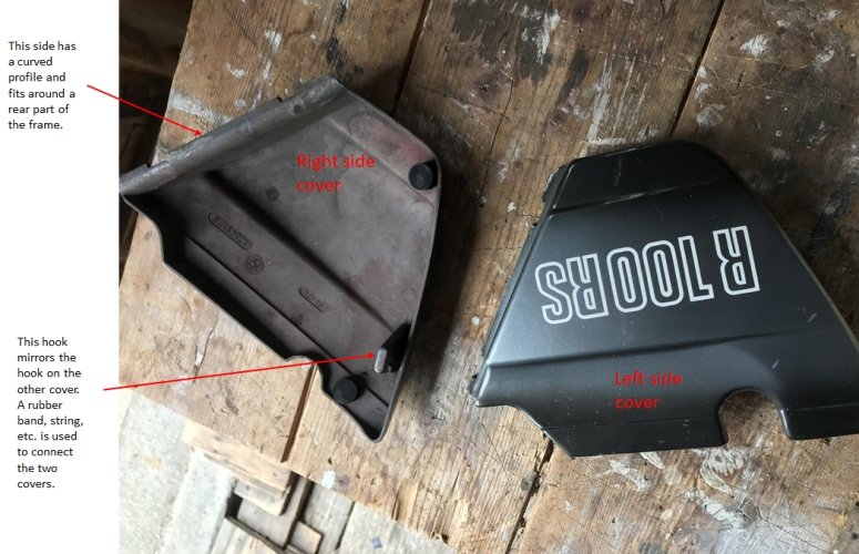

In the mean time I have this delema. I can not for the life of me figure out how the little side covers with the R100 RS emblem mount on the bike!
I attached a picture of the front and back of the covers. There seems to be a hook of some sort on the back that has nothing to attach to on the frame of the bike. That I can see.
If anyone knows how to get those mounted I would really appreciate it.

I use two bungees. 45 years on airheads and haven't lost a side panel yet. The chances of losing both bands at the same time or both bungees at the same time is vanishingly low.
