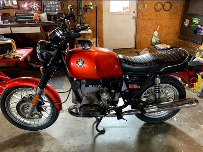

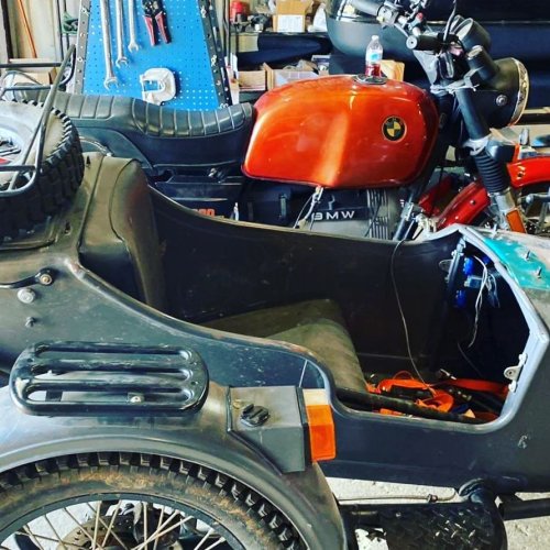

My shop got my sidecar attached! :D
I'm looking to relocate my front master cylinder to the handlebar, but I don't think I can source the right parts needed.
I also need a longer bar for easier handling of the sidecar if anyone would have recommendations.
I need stronger fork springs and a beefy (or even trail reducing) triple tree too.
I am unfamiliar with what parts are compatible across different years. I appreciate all advice. Thanks.
275157266_1105434830258136_7225872221069848853_n.jpg217177802_309315047595552_5790686289617736178_n.jpg
Contact Tom Cutter at Rubber Chicken Racing Garage. Give him the last 7 digits of the VIN and explain what you’re trying to get done. He is knowledgeable and will send you a quote with the parts that you need.
Your thread should be in the sidecar section with regards to suspension and sidecar issues. Does your “shop” know anything about attaching a sidecar? Many don’t. There is also a good source for hack information on the Adventure Rider website in the Hacks forum. What sources have you checked for your brake parts? Try EME.
