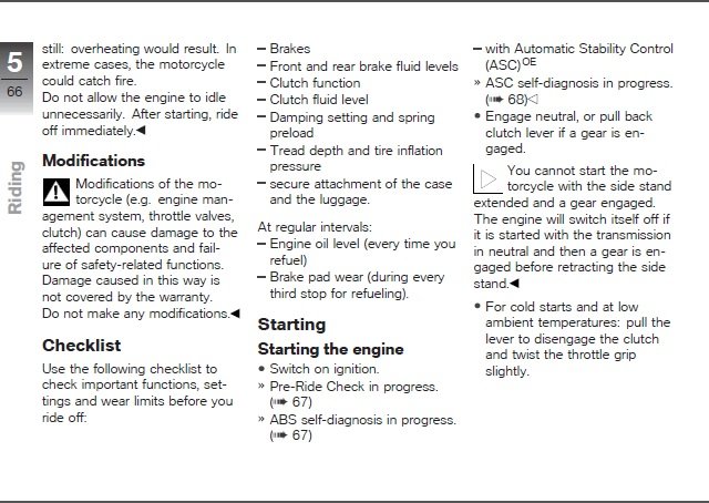

The most common cold start problem seems to be failure to crack the throttle a bit at low temperatures (less than 40ºF).
Last paragraph:
Yes, pulling the clutch lever means the starter doesn't have to turn the transmission and move that cold, thick gear oil.
Opening the throttle a bit means the starter doesn't have to work against as much engine vacuum ... more correctly said have to move air past a closed throttle.
But ... if the final result is clicking, the battery is simply not up to snuff.
And, this thread should be in Hexheads/Camheads, as the latter is what a 2013 RT is.
Last paragraph:
Good News! I did what you (and the OM) suggested, cracked the throttle and squeezed the clutch in 32 degrees and the bike started right up. I will try again tomorrow AM when the temp will be in the single digits and see if it works. I guess if I had read the manual a little closer I would have saved myself a headache, but the dealer could have called that to my attention and saved us both a headache.
Thanks for the help!
