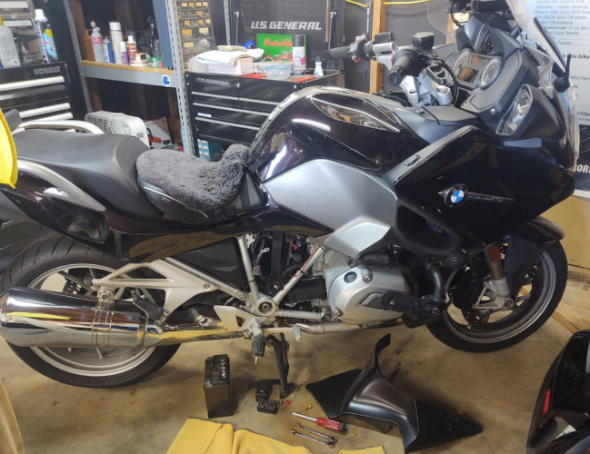

One last note: the battery shown in my previous post was just removed to be replaced with a Yusa AGM battery. It's been on a charger and is ready to go in the bike. The one you see shown was installed 6-6-19, the bike is a 2015 RTW. Roughly 4 1/2 years service on a motorcycle battery is a good haul. I think it's entirely possible that had I not run into health issues keeping me from riding as much as I used to - includes four months the bike didn't move from the garage, sitting on a trickle charger - is the reason the battery gave up.
I've always used AGM batteries when it was time for a replacement in all my bikes, since AGM batteries came on the scene and never had one that didn't meet my expectations for time in service.
