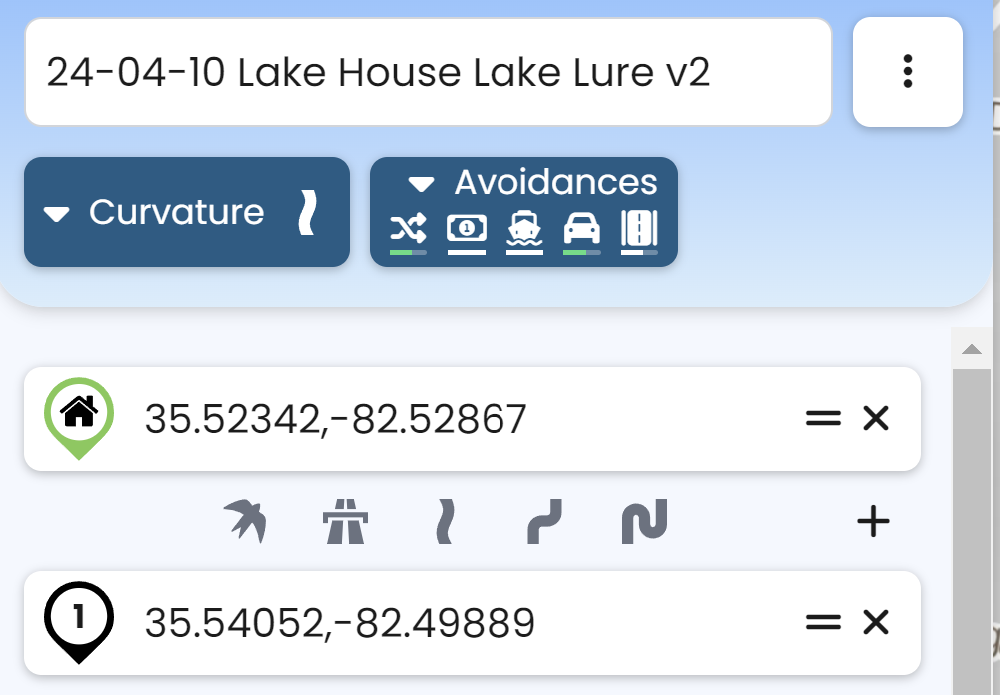

A log depends upon your Curvature setting(s) and your Avoidance on/off/strength settings. In the picture below, the Curvature pull down sets the default Curvature setting for the whole route. You can override this default between any two points by selecting a different curvature icon from among the icons between those two points. The Avoidance setting pull down is where you can turn either turn avoidance rules on/off or set their strength from 1-5 with 5 being the strongest avoidance setting.

Default Curvature vs point-to-point Curvature settings...
Avoidance settings...
