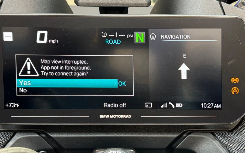

Did I Figure Out My Connected App Problems?
Aha! I think I’ve solved the problem… at least my problem…
tl;dr — Log out of your Motorrad Connected account (in the app) then log back in. This may have fixed all the connectivity and stability issues I had been struggling with.
I went mega meshuga trying to figure out a fix for my suddenly non-stable navigation system. I get a bit OCD about these things. Cutting to the chase I tried deleting then reinstalling the app and re-downloaded the new maps. Needed to log in as part of that process. Still the same problem — gross problems with both the maps mode and app connectivity. Tried disconnecting the battery for a while thinking that might better “reset” the onboard computer… what do I know…? No change. Spent the better part of an afternoon trying to get the app to synchronize and hoping the maps mode would work. Nothing, nada, bupkis, stinko. I sent a long, detailed problem report to the Motorrad Connected team begging for help.
Five minutes after sending the email I had a twinkling of inspiration… the only thing I hadn’t tried was logging out of the app then logging back in. Why should that matter… I had already logged in when I downloaded and re-installed the app in my desperation? The app would not let me log out… curious. I shut down the phone, then rebooted. Went back to the app and this time was allowed to log out. Logged back in with my username/email and password. Boom, the app was back in play.
I turned on the bike, launched the app — the synchronization routine began, and the app was connected within about 20 seconds. As soon as this first layer of synchronization engaged the “starting map mode” sequence began, now requiring only 5 seconds to put the maps up on the TFT display. I waited for it to crash, but it didn’t. I next tried the “torture test” — using the multicontroller to turn off map mode in the Navigation screen, then turning it back on — IT WORKED flawlessly!
So that’s my adventure… so simple, but not necessarily obvious. Further testing to come…
Hope this helps someone struggling with similar issues
Why am I Always Asked to Join the WiFi on the Motorrad App?
Every time I start my 2023 K1600B I have to cajole the app into starting map mode. Even after riding for hours, stopping for a meal, and restarting, I have to try and get the map mode to work. Today I kept getting the error “unable to join network.” I am using my iPhone 12 Pro Max with the most current iOS. IMHO, once the connection to the bike is made, it should work. I read through some other posts about making sure I don’t have a private WiFi and this setting has never been on. Am I missing something?
No- this is yet another issue plaguing IOS. It's not your phone- it's BMW's clown show software team. I bet your iPhone auto connects to every other damn WIFI out there without issue, yeah? So don't drive yourself up the wall trying to fix it on your end.
