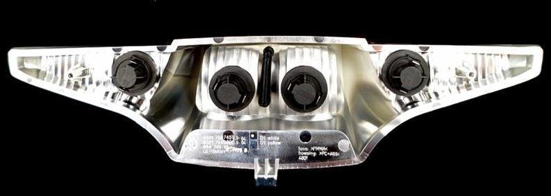

I'm not intimately familiar with the '13 1200 series, but they have TWO bulbs in that rear housing (plus two more for the turn signals). Maybe the computer is saying that one of them (or both...) is bad?
(picture from the MAX website)
Is your bike the later liquid-cooled version? 2013 was a transition year:
If it is, then you have the LED arrangement, and my picture above does not apply, sorry.
But if you have incandescent bulbs, then do the quick and easy thing first.
Another possibility is that one of the brake light switches is intermittent due to crud buildup.
