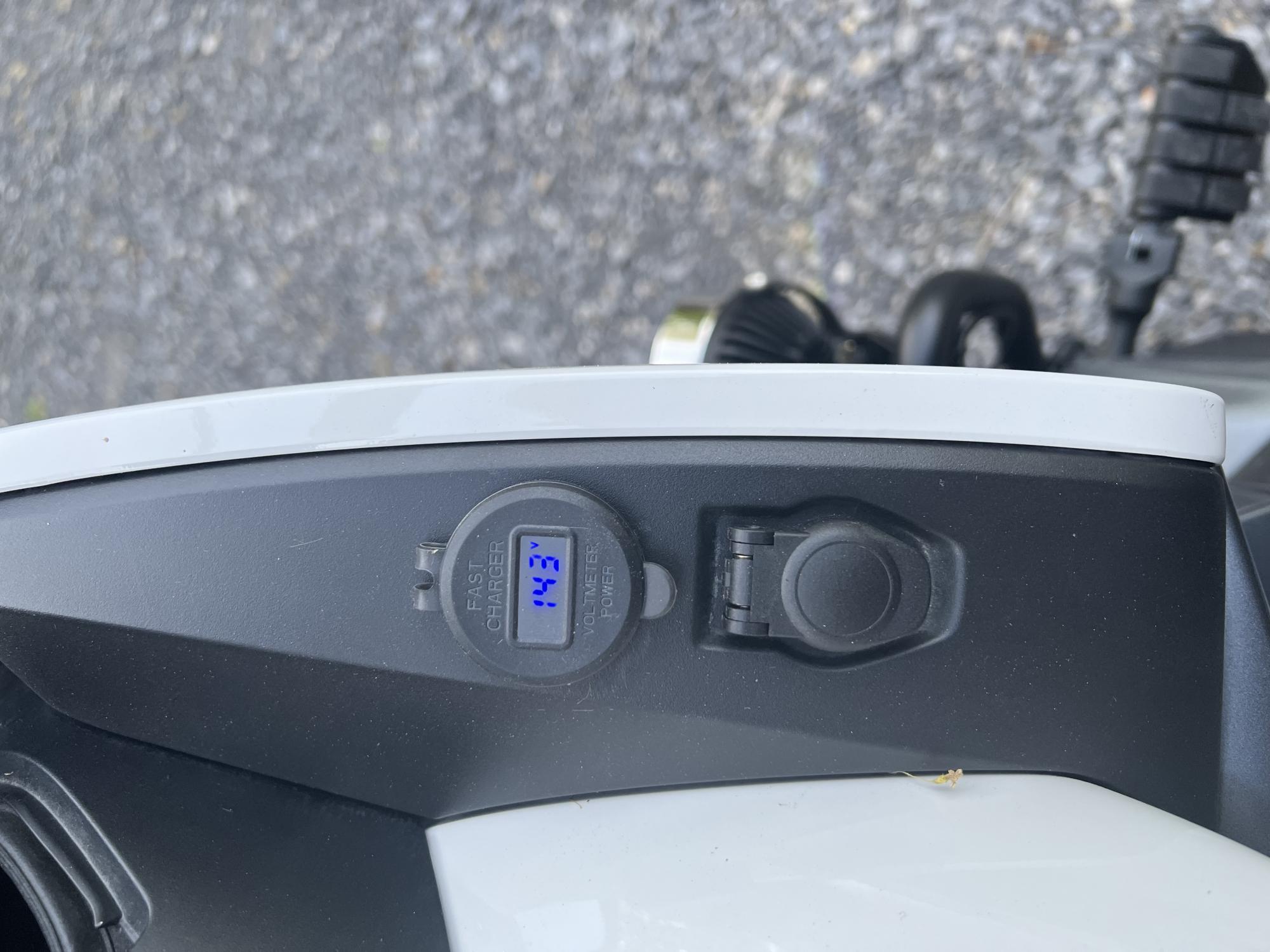

On my RT, don’t know how to rotate and make the pic smaller
Picture is fine. They just render properly if the picture was taken in portrait mode (horizontal) if taken with an iPhone.
