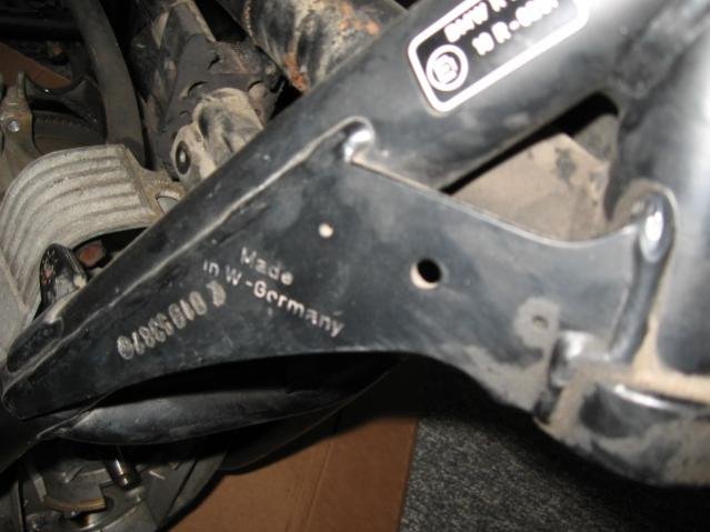

what I pictured before was a 1974 model. This is a 1979 that has the VIN sticker under the right cylinder but still has the VIN stamped into the frame. It's gotta be there unless someone ground it off or filled it in. Or it is a later year frame???

I just went out to the garage to take a picture of my bike, a '75 R90/6 (no "S"). I was built in Oct '74 ao it pre-dates your bike by a few months. As seen in the picture, you should have a ID plate AND the VIN stamped on the frame.
Worst case, buy a VIN plate from Huckey's and a letter/number punch set and make your own. Mount it on the headstock and rub some dirt and oil on it to give it a "used" look. The local DMV won't know the difference or care. Please do the right thing if/when you sell it and tell the next guy what you've done.
(Higher rez picture here)

Ref to image above posted by subagon
I believe this is the number and position you should find
It may have been filled in by repainting or it may be another
frame from another bike and the number removed to hide the
fact of major repair
I have seen bikes with another plate glued over the original
so that a bike could be illegally sold with another wrecked bike's title
The removable info plate usually screwed to the front of the steering head
is not proof of frame vin since anyone can obtain a new blank badge and
stamp it for himself - Many police are aware of this and totally ignore the
tin badge. I never buy or title a bike I cannot find the vin stamped into the
frame as in subagon's image.
