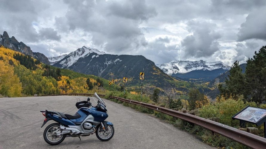

I've owned a 2008 R1200RT for many years. I had a good opportunity to upgrade to a 2016 R1200RT, and decided to stay with the older model. I'm comfortable with the level of technology on this bike, and it's easy to do all needed maintenance without many special tools. The water cooled motors are smoother and perhaps a bit faster, but I've set up my RT for my needs and preferences. It's at 40K now, I'm pretty confident it will clock 100K+ miles with routine maintenance. If you believe the axiom that all the fancy features are potential failure points, then that's a strong argument for the hexhead / camhead models. I found the 'wonder wheel' and menu system kind of off-putting.
Yes, I did experience the fuel strip failure, it's well documented on the forums. Ironically, I ran out of gas on the very first ride (bought the bike from a private seller with 5K miles) with an indicated 1/2 tank. The dealer replaced the first strip under the 12 year warranty program, I replaced the second one myself several years later with the 'new and improved' strip. I always use the trip meter to estimated remaining range, but the bike does consume more fuel fully loaded.
I did have an ABS modulator failure on a trip, but the normal braking function was not affected. Module Masters sorted that out for me over the next winter break.
These models can be very affordable, and have nice luggage options if you are into distance touring. I've concluded that there's no better way to get across the country on two wheels.
