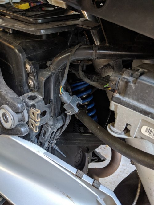

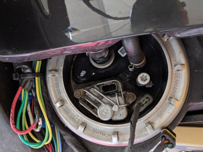

I checked into this problem this past weekend. For the vent valve, the valve and canister had been removed by a previous owner, so that explains the vent valve malfunction code. The fuel pump controller appeared to be original, and I replaced that with a new one. Rode the bike 52 miles yesterday, and all is good. Even when it was not surging/stalling, the bike did not seem to be running 100% before I replaced the controller. Maybe it was always a little starved for fuel. Now its running great and I'm happy to have this problem resolved. I'll use the connector from the fuel pump controller that I removed to make the emergency fuel pump voltage supply cable. Thanks to everyone for their suggestions and help with this issue!
