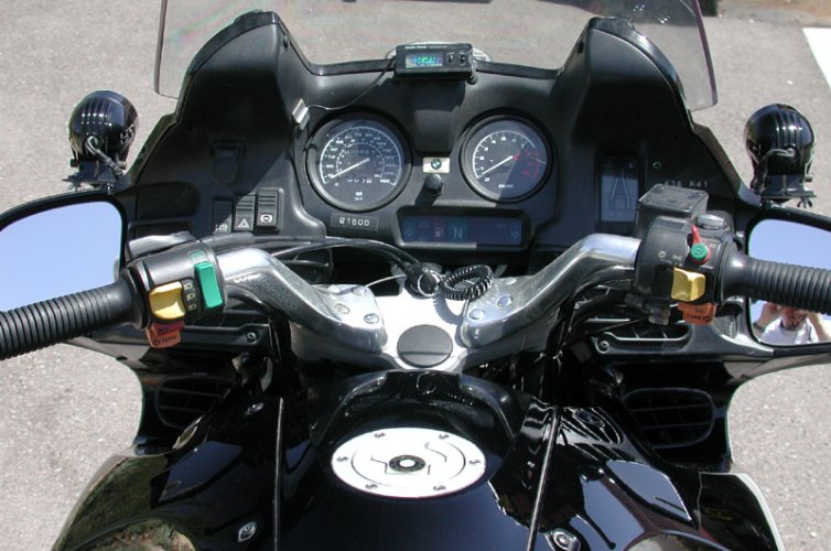

Not sure if this attempt at inserting a photo will work, but the cigarette lighter socket on Scout is directly above the handgrip heater switch on the bike in this pic.
"I have no idea where that really is because I have never seen an RT with an OEM cigarette lighter."
By cigarette lighter, I meant the powerlet socket. Showing my age, I guess.
OK - from the photo it looks like there is room if you are careful and make sure exactly where to put it.

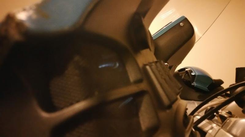

You may have a conflict just behind the plastic panel you want to drill thru. The tupperware is off my 99RT so I went and looked, took PGlaves advice and stood on my head. There seems to be a cable connector coming out of the left side of the speedo just under the panel. This is as good as I could get standing on my head with a phone in one hand, small flashlight in the other. Taken thru the speaker mesh (no speakers), looks like a ghost just below your cicarette lighter.
How much penetration does the SBL switch need??

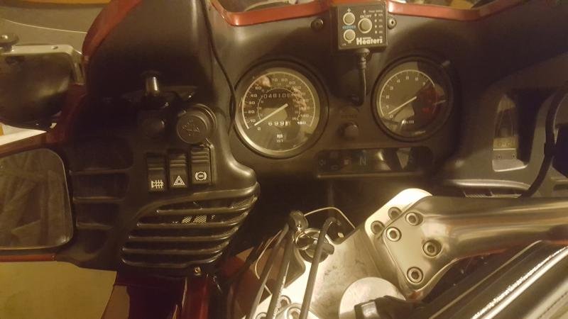

My setup is a little strange, but it shows a few possible suggestions. The previous owner used the heated grip rocker switch to control the driving lights mounted above the mirrors. When I installed heated grips, i used the controller that came with them and put it in the top center of the dash. The turn signal release switch, previously mentioned in other posts, controls the fork mounted fog lights. Above the two charging ports, I installed the volume control dial for the speakers. Above that is a red led light which shines down on the switches below, although that location has very little clearance on the back side, so the switch would have to be pretty small.

The location worked out well. There were several wires from the rocker switch panel routed above the powerlet socket so they didn't interfere.
