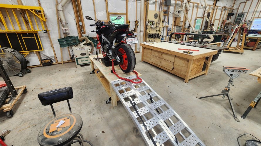

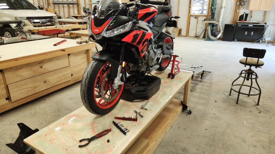

Here's what I came up with.. Nothing too fancy, but gets the bike up and cost around 100 bucks and a few hours of time to build. Working on the 660 right now, but the BMW will get it's turn up there when it's time for tires (it won't be long!!).
