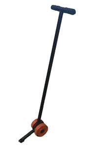

I wanted a lift similar to the Handy Lift, but I wanted to be able to easily move the lift out of the way when not in use. Some 7 years back I chose this one and most importantly I obtained the Wheel Dolly. With the Dolly I don't have to strain to reposition the lift.
View attachment 97818View attachment 97817View attachment 97819
I have a couple hoops on the side of my HF lift and put a piece of rope on it. It has four wheels, so I just lower the stabilizing pegs and can move it.

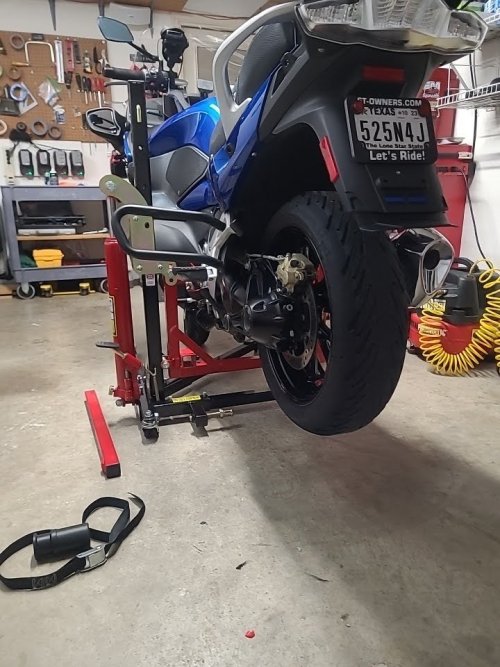

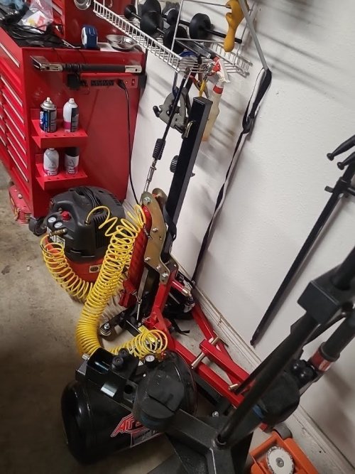

I have a ABBA lift and love it as the bike is lifted off the floor which was handy when removing the shocks for a rebuild. It rolls around easily on the floor in the warehouse when it needed to be moved out of the way. It also stores in a corner out of the way so it takes up hardly any room.. YMMVIMG_0745.jpeg
