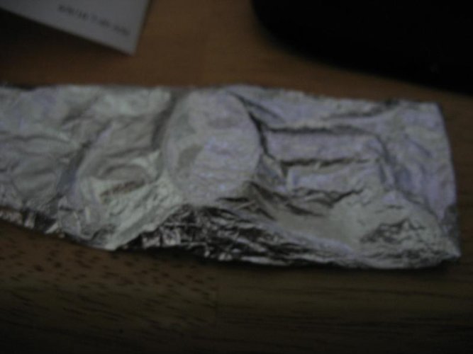

Have not read about this before so am posting. Yesterday we took our 2009 R1200GS to South Sound Motorcycles in Tacoma to have the tire pressure monitor system deactivated. While at the service desk talking to Neil I took both of our keys to the bike out. Neil asked me where I have been carrying the spare key and told him in my jacket of course. Neil then told me of the problems they have had with the State Patrol doing the same and the signals sent out from the bike ignition to the key also picks up the spare and can burn out the ignition. I was told to wrap the spare key in Aluminum foil to block the chip or carry the spare key at least 3 feet away from the ignition. In fact, before I took one of their bikes on a test ride, the service manager went into the break room and got some aluminum foil and had me wrap the spare key so it would not affect the New BMW that I was to ride.
Was told a pocket protector like for new chipped credit cards will work also.
Photo of what we did.
Just what we were told and passing it on so maybe others will avoid any potential problems.
Hope that helps some one.

Doesn't make any sense. BMW did have an issue with the key antennas where the key goes in. It didn't have anything to do with what your dealer said, but was a flaw in the production. BMW replaced something like 17 thousand of them a few years back.
Maybe he rides thru the chem trails? This makes no sense. I'm assuming the 2009 is same as my 2008.
A transponder key system is pretty simple. When you turn key on, EWS ring (induction coil) energizes, the transponder chip in key will energize and transmit key code. Once validated the ECM will disable the immobilizer circuit, and turn off the induction coil. It's only on for a short couple of seconds. If you bypass the actual switch, you can ride around for days (without turning ignition off) and leave the key at home as its only used during that brief period when engine ignition is turned on. I have done this when my Ignition switch failed on my RT.
The range of the induction coil is literally mm not feet.
I'm calling BS on this one, but if I'm wrong someone please explain the physics.
