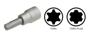

My T40 Plus will fit but it's looser than I like.You had me thinking, so I called BMW and talked with a tech. He said it was the T40 Plus.
On a Wethead the clutch or brake fluid reservoir caps are held on by Torx Plus.have a Neiko Torx Plus set. I only use the one out of the set for the drain plug
Yep, I also almost "buggered" my FD drain bolt, before I figured out I had the wrong bit. Now, I don't touch it unless I manually pre-fit the bit to the bolt, and see, and feel that it's a solid connection. As I mentioned before, too, a new washer and proper torque helps a bunch, too. (I also have to look up the exact type of washer every time, copper or crush, whatever, BMW's weird on this. The washers for the oil drain and FD drain are different types, which I discovered when I switched them and found a pool of motor oil in the morning after I had changed to oil.) Your friend's mistake is an exceedingly easy one to make.Yes, my friend is upset with himself for stripping out the head of the bolt, which started the spiral downward for him. That bolt requires a t40 plus. A regular t40 will work, and most use that, but after a while, you find yourself in the same situation if you are not careful.![]()

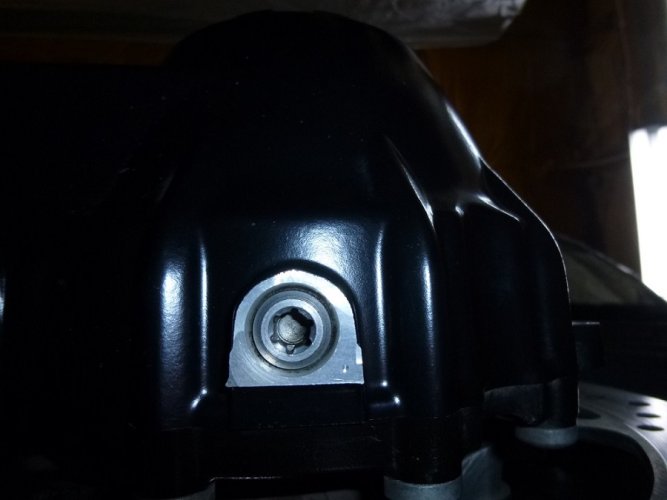

T40 Plus for the final drive drain plug on a Wethead bike.OK, this is clear as mud. It is clearly a plus torx, but is it 40 or 45?
40plus seems to be common, 45 not so much.
Not a hardware store fastener to found on these bikes.
