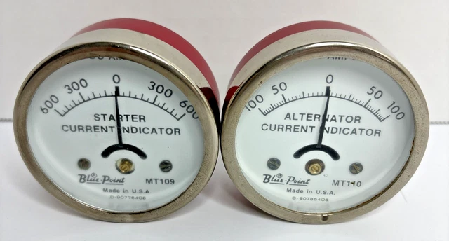

It would be nice to see the amp draw on the starter. I value my Blue Point set for this-
