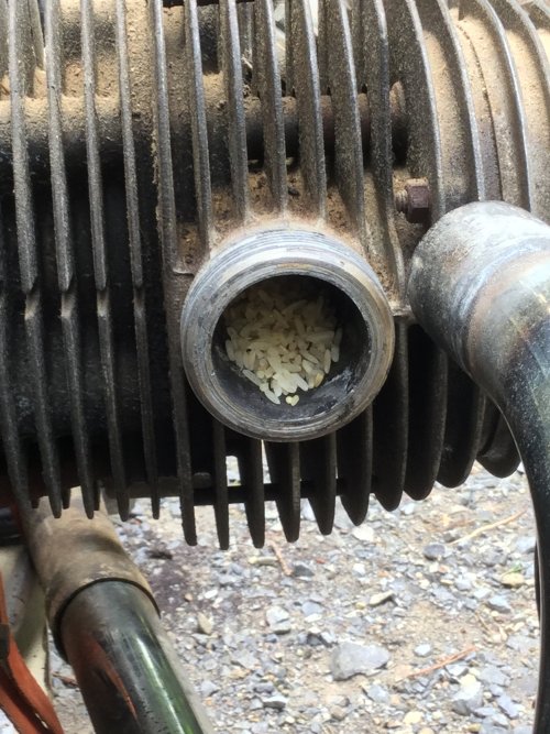

Here’s another from that 1972 R 60/5 SWB…
Core of the bike sat on the oil pan in the barn; mice took advantage of open headers to stock the cupboard !

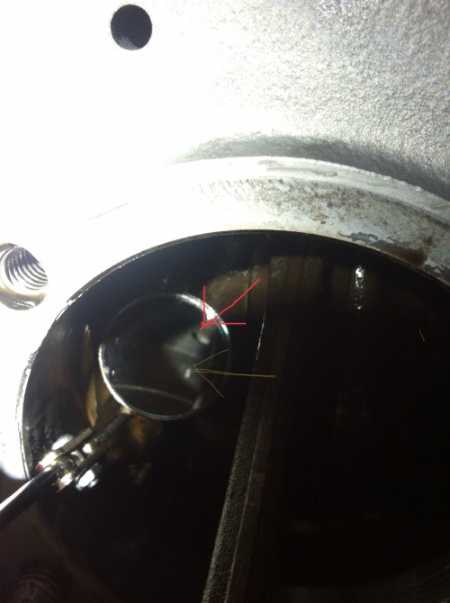

Bought a R60/5 to restore. During tear down found a lot of brass particles when removing right valve cover and rockers were worn out. With out knowing history of the bike I chalked it up to who knows what happened. First start up after restoration I removed valve covers to check for oil flow. Left side had good oil flow, right side had a drip of oil once in a while. Removed cylinder and did not see anything obvious. Removed top cylinder stud and put a blow gun at oil feed hole and heard/felt air rushing out of block between top cylinder studs. That spot is machined for connecting rod clearance and was machined through the oil gallery that feeds the rockers. Red arrow shows hole in oil gallery, yellow arrow shows oil passage feeding cylinder. Found a BMW service bulletin from that era stating to check for bad machining when having low oil pressure problems. Ran that way from 9-71 to 2016.

A’yup… gotta love these Airheads ! Good work Doug, really good (y)
How was that repaired; not an easy one I suspect ?

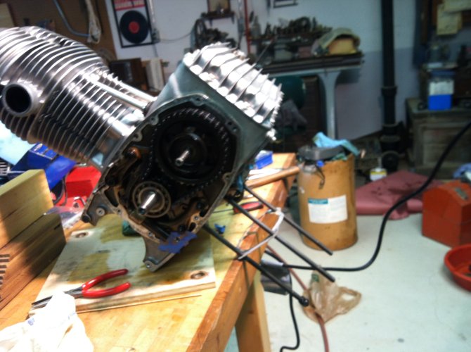

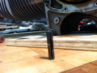

To repair I removed the front cover stud that is inline with the oil gallery. Bought metric and standard roll pins to test fit. Scribed the center and ground open at scribe. Oil gallery is cross drilled to feed cylinder. By modifying the roll pin I knew when the center of it would align with cylinder feed. Once driven in there is no way to remove roll pin, alignment was done by eyeball and all worked out. With engine on bench and upside down, loctite was applied to wick in where roll pin was visible. This was done to seal up that area. Oil flow to both valve train is now equal.

FANTASTIC !!!
What a truly great “Field Expedient Repair” for an OEM machining error, Doug !
In essence, the roll-pin became an internal t-fitting; being hollow to flow oil, it diverted oil too !
I’ll be putting that in my “Book of Wisdom”, labeled as the: “Drost Oil Gallery Salvage”
