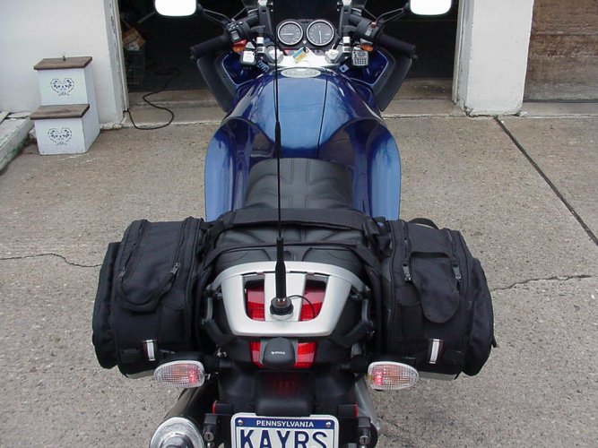

I have the same set up with the Xact receiver. But I have the antenna monted behind the rear luggage rack on a metel plate. I have noticed that when I go on heavy tree lined road I will loose the signal. But besides that it seems to work pretty good.
Sirius Set Up (antenna)
Antenna mount.
