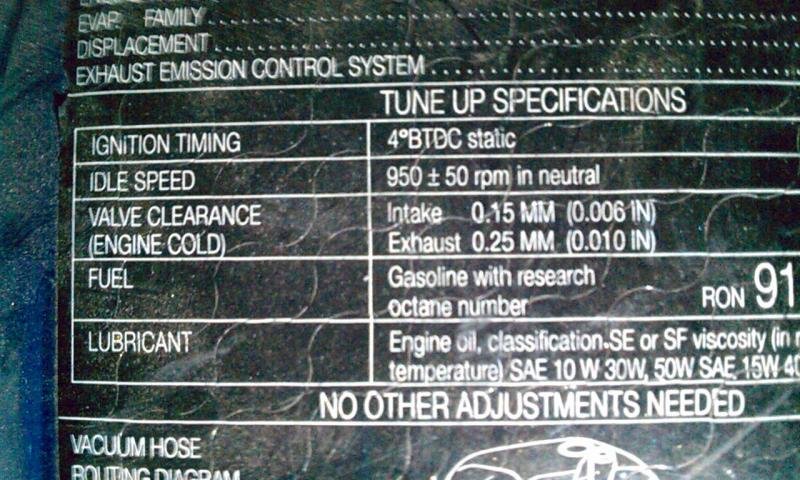

My idle is a little low then. I went off the OEM sticker that say idle is to be 950 rpms. The light flickers once the tach hit 1000rpms and goes solid for rpms under 950rpms. Once I get on the throttle even a tiny bit the light goes out.
As Paul said - idle on the K75 is supposed to be 1,050-1,100 RPM. Dunno what sticker you're reading. It will also tend to stall on occassion coming down from speed if the idle is set below 1,000 RPM. The 4 cylinder can idle at 950 OK..
The sticker underneath the seat on the bike

Since it specs ignition timing at 4 degrees BTDC, it is a K75 sticker.
