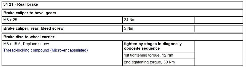

Rear Brake Caliper Torque
The specs I find on the Internet are all over the board - but I buy the 18 ft. lb as posted. Sorry for the confusion.
