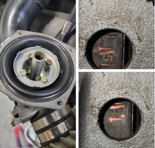

Hello all, I seem to be having an issue with my 1975 R75/6 cutting out at about 5000 RPM,
the carbs are clean with good diaphragms, the points and cond. are new, I thought it might have been the coils so I replaced them with new ones
from EME (endurolast EDL-Coil6Vx2) I have set the points and timing to spec, I do have a bit of differential due to the points follower / cam bent issue, but I have set that to average out the differential. ( one one side the s mark is at the top of the window and on the other the bottom. and I am running the stock BPR6ES plugs. I'm running fresh 93 no ethanol gas. and the valves have been set to spec. Also when I rev it with the cover off I can see the "advance wings" coming out to advance timing. The bike starts beautify, and runs strong UNTILL it hits 5000 RPM and them all most acts like it hits a rev limiter. Any ideas of what to look at next?\\
Thanks Jerry

gearing does not matter, sitting on the center stand in the shop , it starts sputtering right at 5k, or on the highway in any gear. gas flows freely, I can remove the bowls and it will flow all day. new petcocks and gas cap, air filter and hoses . carbs are all stock to the best of my knowledge, This one has me stumped
Jerry

Limited RPM at 4k - 5K is often the diaphragms. Would be worth pulling them out and checking them again. Just because they are new doesn't guarantee one didn't tear. You also said you had, BPR6-ES plugs. Those are the resistor plugs. Did you change the caps to zero resistor caps? Is it possible that too high resistance in the plug wire circuit is limiting RPM? Can you swap out for non-resistor plugs?
