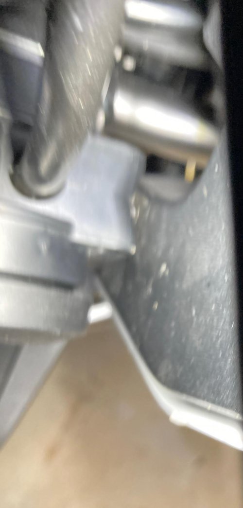

The horn body is mounted to the left inner fender, with a fender washer on the back (outer) side of the panel.
![IMG_1176.jpg IMG_1176.jpg](https://forums.bmwmoa.org/data/attachments/72/72374-97dcd7d8c5165b1efd149db25df9ad07.jpg)
The horn is positioned so that the fork clears with at least a 1/4" to spare. Because it is an upside-down fork, the outer tube never moves up/down, so the horn will never interfere with the fork leg.
![IMG_1180.jpg IMG_1180.jpg](https://forums.bmwmoa.org/data/attachments/72/72375-5ec7669324767aa13e37348d395f1057.jpg)

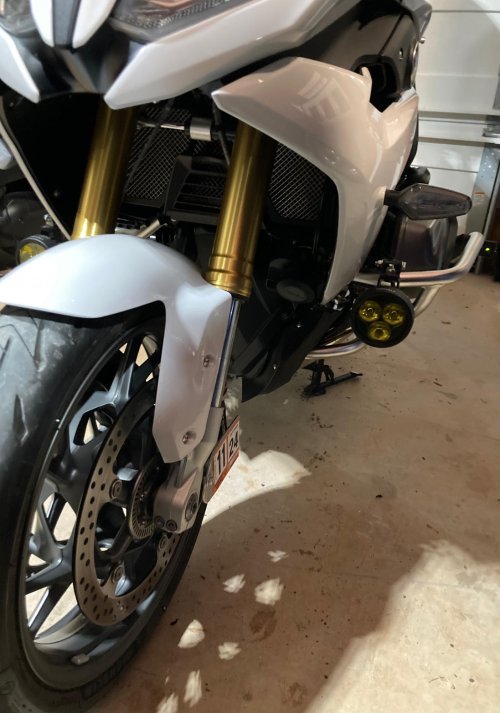

You have to be looking for the horn body to see it.
![IMG_1182.jpg IMG_1182.jpg](https://forums.bmwmoa.org/data/attachments/72/72376-8c7f93a6a6e9384eca83ff3cc3257803.jpg)
