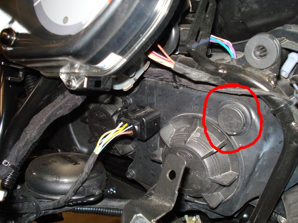

I washed my bike after the rally and both 194 parking light bulbs went out. I've replaced the headlamps a couple times with no problem. Can someone pass along tribal knowledge on accessing the parking light bulbs? Its not covered in my '05 manual. Thx

I don't have my manual anymore but here is a picture of the cover of where the 194 bulbs are located.
Shown is the throttle side, it would symetrical for the clutch side.
One thing to be aware is this picture is from the Nacelle removal DIY so i have the front end partially disassembled.
So when you go back to your bike you will see where they will be located to replace, at minimum you will need to pop off the mirrors to access.

Remove the mirror on the appropriate side. Just pull firmly to remove.
You may also need to remove the two phillips head screws to remove the trim panel. Be careful as the trim will just fall off when the screws are removed.

Thanks everyone for the info/input, I really appreciate it and changed the bulbs very quickly with no problems. The socket is actually a little to the outboard side from the item (cap) circled in red. Of course I had to go for a ride to make sure everything works:laugh. Great idea mounting the XM. I've been to the forum to research and performed all maintenance myself with no issues. This was the first time I posted a question (forum virgin). I'm very impressed with you all, such a great community. Enjoy the ride!! Thanks again.:buds
