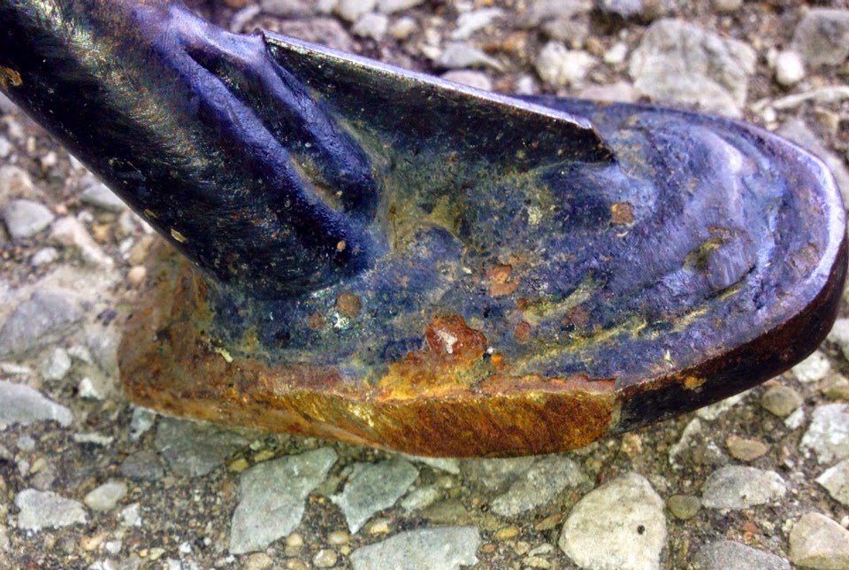

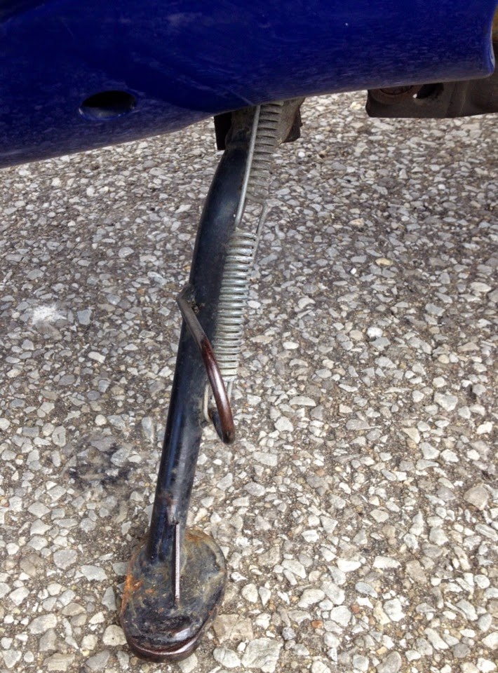

A previous owner of my R1100RS welded a plate onto the side stand to enlarge the base. Unfortunately, it was the first thing to touch down in a turn and nearly put me on my side one day when it took pressure off the front tire mid turn over a hump. I have since ground down the offending side of the plate so the centerstand and side stand kiss the pavement at the same time. I mention this because the bolt on foot looks even larger than the weld on piece on my bike. I'll add photos later.
Later is now
If the R1150RS side stand doesn't tuck in better than mine, I'd be careful with enlarging the foot.
