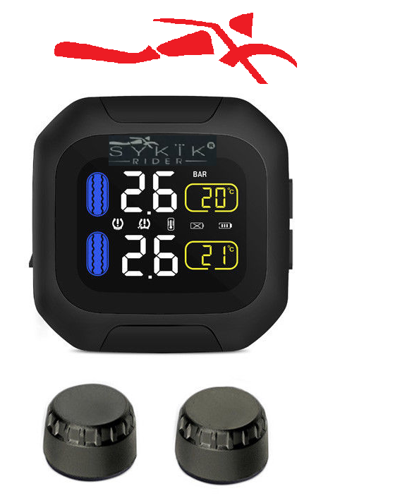

Looks interesting and quite affordable-
SYKIK
$54.95
$59.95​
SRTP300 MOUNTED TIRE PRESSURE MONITOR​
Nice that the batteries a user replaceable. The first kit I owned for a 6-wheeler, batteries were not replaceable and new sensors were $50.00/ea.
