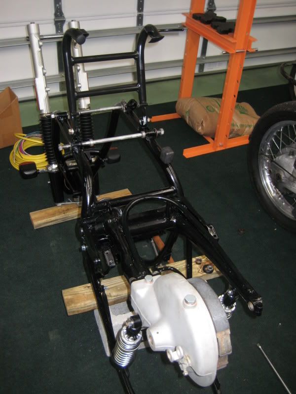

Since it has the VIN, I doubt BMW would sell a replacement. I'd just carefully mask it.Does anyone know if BMW will replace this sticker? I am thinking of taking all the black parts to get painted or maybe powder coated, but I'd like to keep the original look of the frame.
You want to be VERY careful with that sticker and preserve it - I've heard of some folks going through tremendous nightmares at the DMV trying to re-register a bike that has been restored, but in which the VIN sticker was lost in the process. It *might* be possible for the original manufacturer to make a duplicate replacement sticker for you, but they are not required to, and I'm pretty sure such request would go to the very bottom of someone's "In" basket back in Munich.
Kurt,
DO NOT DESTROY THAT EPA STICKER!!!!
I just spent 5 months and 5 trips to the DMV, AAA, local Police Sub-Station and CHP because I didn't file a non-op on my 81 R65 restoration project and the powder coater destroyed what was left of that sticker. Best advice is always keep your registration current, if you're not going to drive it, file the non-op. All 7-digit VINs have fallen out of the DMV system since they now require a 17 digit VIN. It's obsurd, but true. The matching Vin's are clearly stamped on both my right frame gusset and engine case but this seemed to take less priority than the missing EPA sticker on the right lower frame rail. In fact, I would suggest you guys photograph your stickers if you have them to historically archive them. Photoshop and adhesive mylar can do wonders these days.
You don't want to hear the gory details. Good news is; I finally received my plates. I honestly think they ran out of forms and inspections for me to fill out and have completed.
The VIN is stamped on the neck of the frame, so I'm not too concerned; I have a picture on my shutterfly pages. But, it sure is easier to read the VIN from this sticker...I'll probably just tape it and paint the frame myself. I just want to make sure I get paint that doesn't flake off in a year, and ruin all this work...
