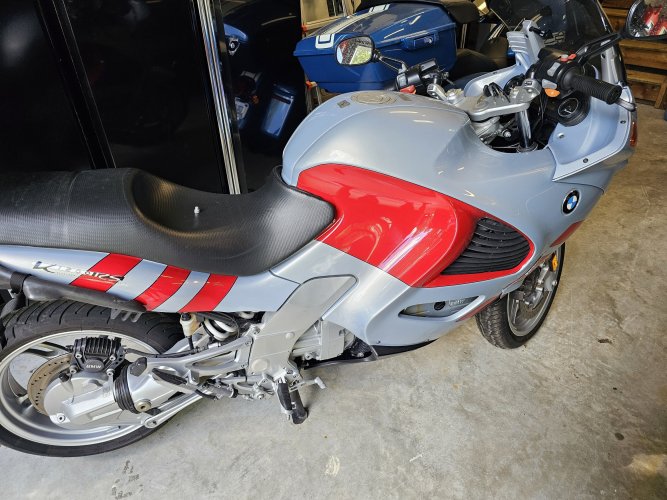

kculver1059 -
Were you able to get the correct BMW colors from English Color and Supply? Is Yes, can you provide the paint information. Need to paint a new set of fairings for my 2002 K1200RS. TIA
