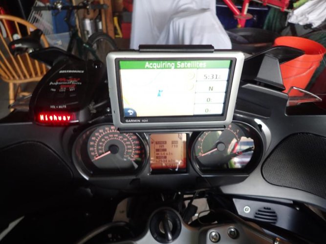

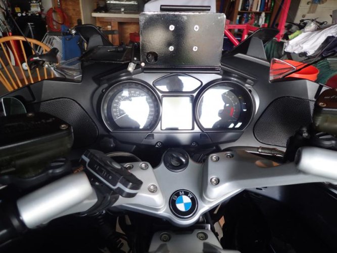

When my trusty Escort 8500 finally died I thought I would try a 9500ix. After I blew the first one out connecting it to a Sena SM10 without a ground loop isolator I decided it was not a suitable unit for my bike. It also picked up a lot of sound interference and the buttons were too small to be practical with gloves. It had way more bells and whistles than I would ever use. So I went with a Beltronics Pro-100 for a lot less money which I am told is made by the Escort people and uses some of the same innards. Have had that for a year now and I’m very happy with it. Sensitive enough and very few false alerts, plus the buttons are simple. It also has a sound out mini plug which I route into the SM10 and it all works well. I sat the unit on a small platform I made to the left of my GPS. If I am on a super bumpy road it will jiggle a little but the Velcro underneath keeps it on well.
I am no expert but it's my understanding that you should have the receiving end pointed forward and a higher mounting will pick up radar sooner than a lower one if you are alone out on an unbusy road. I recall I got a ticket the first time I used my 8500 way back when so IMHO it is more to warn when smokey is around so that I am on my best behavior. Probably not going to save you with today's super fast police radar. ;)
