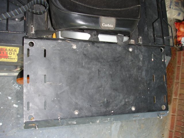

Just bought a second GS and intend to make my on out of 1/8 alum. or diamond plate. will make it about 20" wide and about 12 or 13" deep. drill several several small holes around the edges and mill a couple of 1" by 3/16" holes for straps. The top of line rack has a 1/2 hole in each corner which is handly (I drill similar holes in the Jesse). suggest making it wide enough to set under you grab rail for extra support (the top of line had this feature, the jesse does not.
Hope to see you in Vermont.
Gary

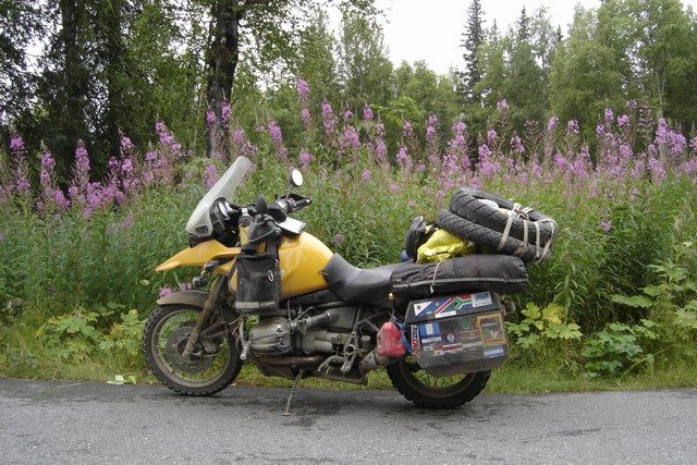

this photo taken in Alaska. Not two-up but with a fair load. I try to keep my crap forward and low. Compression bags help a lot. anything that will compress, ie clothes, sleeping bags; put in a compression bag.
Gary

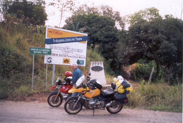

this one was taken at beginning of Darien Gap Panama. Early on with ownership, before Jesses bags but with top of line rack. and also before benefit of compression bags and light weight clothing.
Gary
