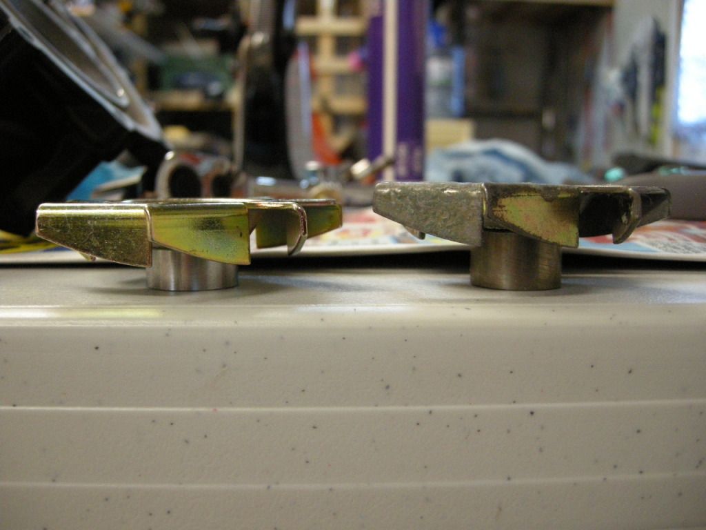

K75S Water/Oil pump rebuild
Just noticed that I already had the new impeller/rotor on my 93 water/oil pump. What I do find odd is the fact that the bushing that is now sold with the new impeller is not as thick as the old one.
This will have an impact on space between the impeller and the pump housing and cover. Anyone care to comment and would you install the new thinner bushing or stick with the old bushing; I am replacing that corroded impeller.
