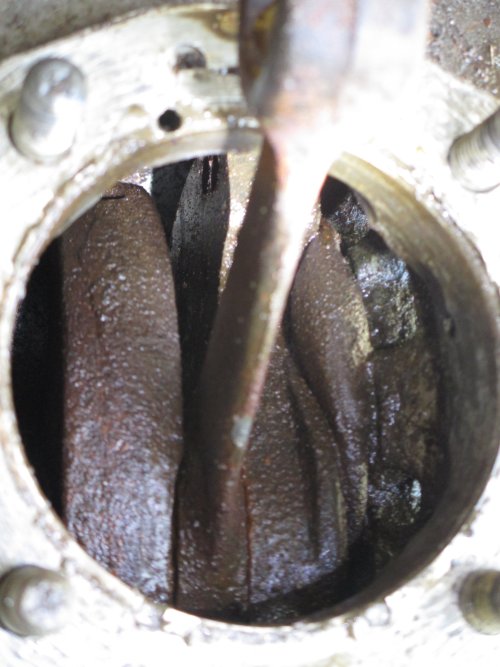

Here's a picture I took when I was starting to open up my R69S for slinger service. The arrows point to the slinger. It has to be very close because of the way the slinger works. The /2 has a low pressure oiling system. The slinger is a large "washer" but it has a cupped edge to it. Oil is directed into the flat part of the slinger and then the rotation from the engine slings the oil out to the cup region. The centrifugal force separates the solids from the oil, and the liquid finds it's way to passage in the crank web to the bearing surface. If the cup region gets way full, oil to the bearing is significantly reduced.
