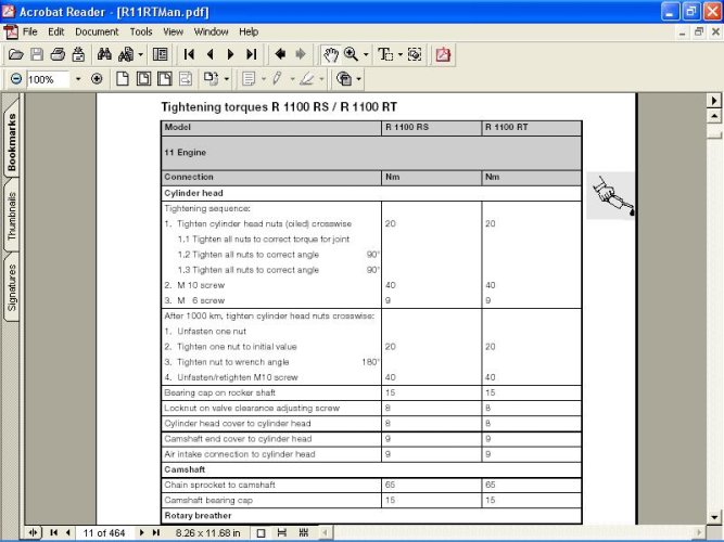

Tim,
Here it is right out of the factory manual. 20nm is 14.75 FtLbs.
Mick
Thanks Mick,and Rich I,m redoing because I used to own an air head and when I got the oilhead I did the valves the way I did them on my air head,retorque then set valves--but I used clymer to get the torque and found that 90 deg might not be right,anyway I torqued them to the correct angle and now will leave them alone.
