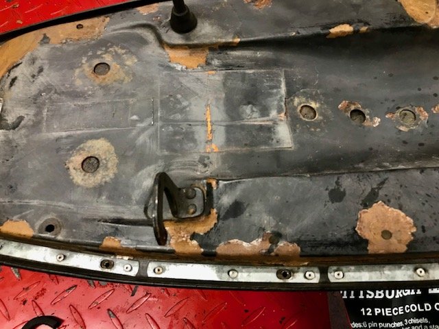

I took my Corbin seat off of my 84 R8ORT at the beginning of winter as I am doing a restoration of the bike. As part of this, I am having paint done and so removed the seat from its cowling. When I removed the seat, I also found the hinges were bent as such I straightened them and forgot about them.
Now, I am ready to have the bike pinstriped and the painter has asked me about how to mark the gas tank pinstripe so it aligns with the seat cowl stripe. We were going to mount the seat in its cowling on the bike along with the tank and mark it up for the stripe.
I found to my horror the seat when the hinges are installed does NOT sit on its bumpers on the frame as does my stock seat on my RS but instead is held in place up off of the frame by the Corbin hinges. This would explain why I had to send the seat back a year ago for repair when a hinge pushed though. Too much weight on the wrong point.
So with the seat metal cowling on, this is not readily noticeable..
As it stands now, the seat is supported only by the two hinges which of course mount to the two small pivot points on the frame, and the locking stud. I find this suspect and not a good way to mount as there are bumpers on the seat and I feel they should bear the weight not the hinges and light pins.
If anyone has a Corbin seat on their bike, can you take a quick look to see if your seat is properly seated on the bumpers or if it is supported by the hinges only? I don't want to pinstripe with the seat obviously up higher on the bike then it should be.
Also, does anyone know if Corbin makes a different hinge? I will try to call them today. Mind you, after a major experience with them a few years ago, I am NOT a fan so dealing with them is the last thing I want to do. Thanks for the replies, St.

Every Stock BMW seat I have looked at sits on the frame with the bumpers taking the weight. Only The Corbin sticks up in the air and bears the weight on the delicate frame hinge pins, hinges and plastic body.
Corbin's answer is they don't have any other hinges to send me, there is not much they can do as it is an old unit, perhaps I can make a gasket to fill in the gap?
So, no, I am not going to make a gasket, I bought a seat that was supposed to fit my bike, I am not going to modify my bike to make the seat fit. The Corbin is coming off and I will be buying a stock seat if I can find one.
