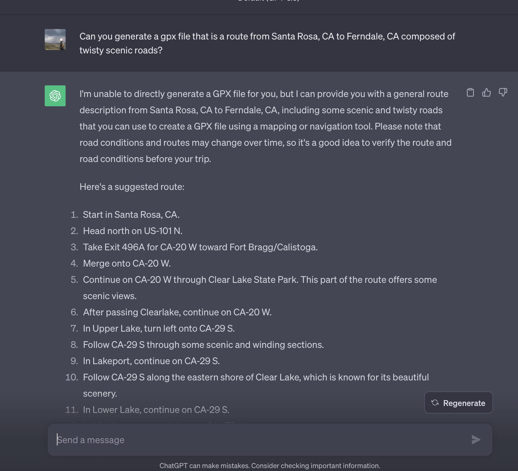

And now, I want to go play with ChatGPT some more and see if it can give me a gpx or a route based on my preferences and description.
"Make me a route that visits Avenue of the Giants, Booneville, Clearlake, Mendocino and Fortuna that avoids highways and uses twisty, scenic roads. Export it as a .gpx file"
Maybe that's my new post retirement career. Adding AI capabilities to Garmin's horrible interface. :ha No direct export yet, but that API integration sure seems like a way to make it work. Maybe I'll go play with Google's tools for a while. OpenAI isn't ready yet.
