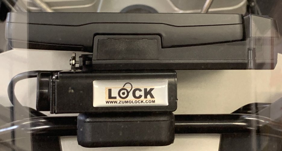

Here are a few photos of the completed project-
Unlocked
Locked
Front
Behind
Unlocked
Locked
Front
Behind
