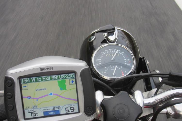

Over an hour at interstate speeds yesterday. There is indeed a sweet spot around 5,000 rpm. Thanks guys.
